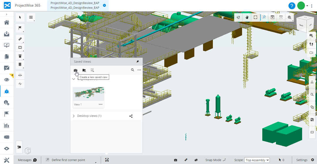

To create a new saved view:
Set up the view the way you want it.
Open the Saved Views dialog and click the Create New Saved View icon (camera icon).

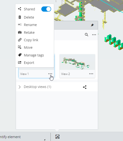

- Enter a name for the saved view.
- If you want other team members of this ProjectWise 365 project to be able to use this saved view, click the More Actions button (...) next to the saved view you just created and turn on the Shared option.
