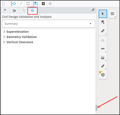

Finding the command
In the Civil Frontstage, open the left widget panel and select the Civil Design Validation and Analysis tab.
 After selecting the Civil Validation and Analysis widget, click the drop-down menu to access the Geometry Validation tool.

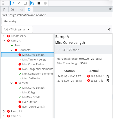

The results of the validation are presented in the widget. You can navigate the results for each alignment by expanding/collapsing the headings.
When the evaluated parameter is selected, the detailed results are presented in an additional open panel. You may need to re-size the panel after it opens.
By selecting the element in the right panel, the model view will zoom to that element. An issue can be created directly from the results panel for a failing element by clicking the Create Issue         button.
