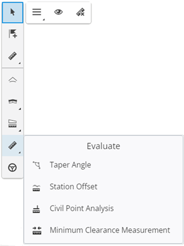

Finding the command
In the Civil Frontstage main toolbar, select the Evaluate icon
Taper Angle

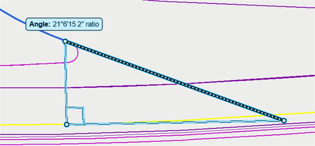

The tool has no control settings, it simply requires two inputs that are prompted in the bottom left of the frame
The resulting measurement is a result of taking instantaneous bearings from the two points on their elements, extending those as construction lines and presenting the resulting ‘construction triangle’ in the graphics

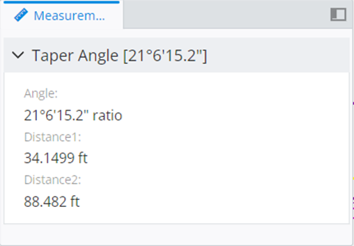

Selecting the measurement allows viewing the computed distances for the projected vectors.

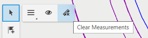

Dimensions are temporary to the session and can be cleared from the view by Selecting from the Tool Palette
