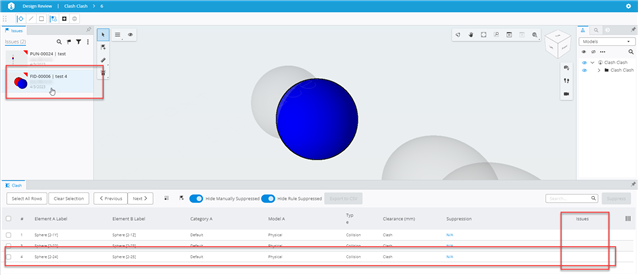

Clash Issues do not show in Visualize Results Issues column
Issues created in Visualize Results dialog do not show up in the Issues column.

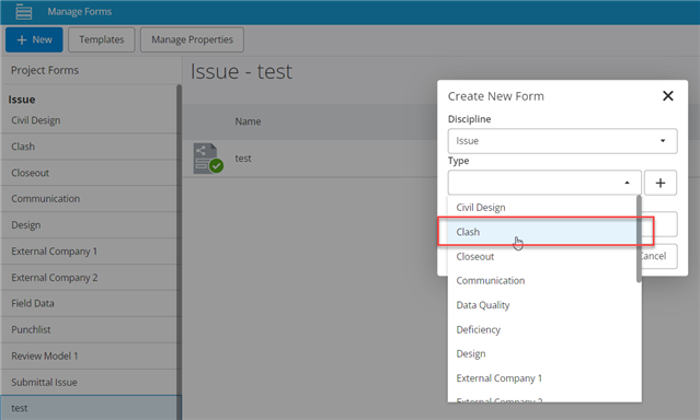

Only forms created using the Clash form type will show under the Issues column.
If a Clash form does not exist create a new one in the https://connect-formmanager.bentley.com/designer create a new form using Clash Type.
Once created use the Clash form when creating new issues in Visualize Results.
