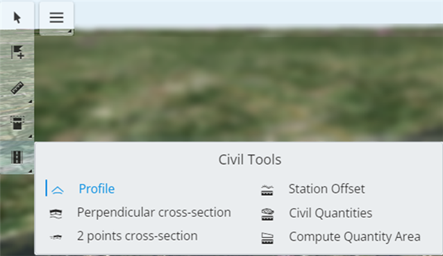

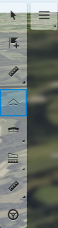

Finding the command
From the Default Frontstage main toolbar, open the Civil Tools icon and select Profile icon
 In the Civil Frontstage main toolbar, select the Profile icon

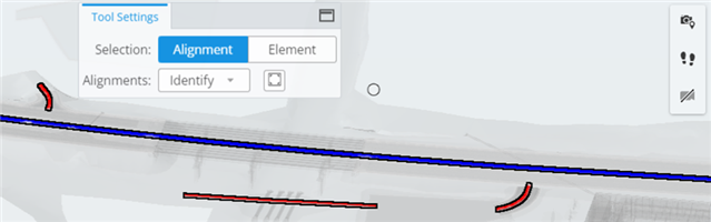

Profile Selection Tool Settings

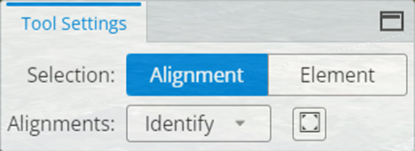

Profile selection can be made by two modes
The graphics will auto highlight Alignment to aid in selection.
A named selection is available using ‘Identify’ option where a named list of Alignments is presented to select from. The ‘Fit View’   option can be used for larger models, limiting the list to those contained in the current view.

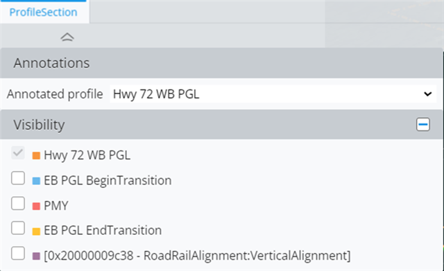

Profile Annotations
The selected Alignment / Element is annotated using the Text Option toggles in the Profile View Options menu on the right of the view. Note for Elements this annotation is limited to slope between points.
The element annotated and visibility of additional Elements can controlled in the ‘Profiles’ dropdown on the left of the view.

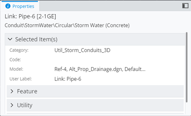

Selecting graphics in the profile opens the Properties dialogue for the element.
