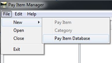

Use Quantities > Pay Item Manager to create a Pay Item database in InRoads (File > New > Pay Item Database).

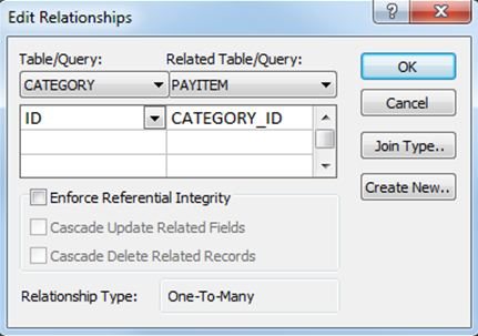

Open the database with Microsoft Access. Go to the toolbar at the top and select Database Tools > Relationships. Between Category and Payitem there is a relationship. Right-click on the line between them and select Edit Relationship. Toggle off "Enforce Referential Integrity" and select OK. Close the Edit Relationship dialog.

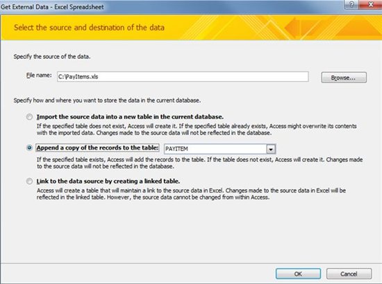

In Access, go to the top and select External Data > Excel to open the  Import wizard.  For  "Specify the source of the data field", Browse to your Excel file with the pay items. Under "Specify how and where you want to store the data in the current database", select Append a copy of the records to the table.  In the drop down list, select PAYITEM and OK. The next dialog should have the columns separated correctly, as they were separated in Excel.  Next.  Finish. Either the data is imported successfully or it reports the number of records lost.
The number of records lost is caused by either duplicated pay item Names or empty fields in the spreadsheet. Cancel the wizard and return to the spreadsheet and look for the problems. When errors are corrected rerun.

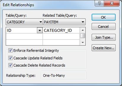

Re-open the database in Access and go to the toolbar and reselect Database Tools > Relationships. Right-click on the line between Category and PAYITEM and select Edit Relationships. On the dialog toggle on "Enforce Referential Integrity" and the two toggles below it. Select OK and close the Relationships and then close the database in Access.
