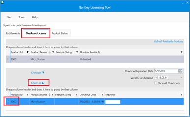

How can a license be checked in Subscription Entitlement Service on the client machine?
  1. In Bentley Licensing Tool, go to tab Checkout License.
  2. mark the product to be checked in in the lower area.
  3. Activate Check-in
  4. after successful check-in, the product is removed in the lower area and added to the number of available numbers in the upper area
