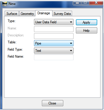

How do I add user data fields to the drainage database (*.sdb)?
Answer:
  1. Go to File > New > Drainage.
  2. Set the Type = User Data Field.  Set the Table Type, Field Type, enter a Field Name and click Apply.
