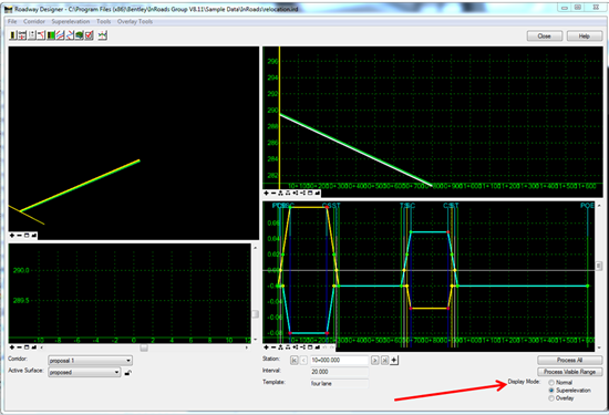

- In Roadway Designer, change the Display Mode to "Superelevation":

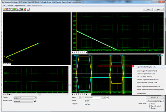

- Right-click in the on the Superelevation Diagram and select "Superelevation Display List":

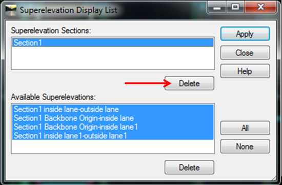

- Highlight all available superelevation sections and select "Delete":
