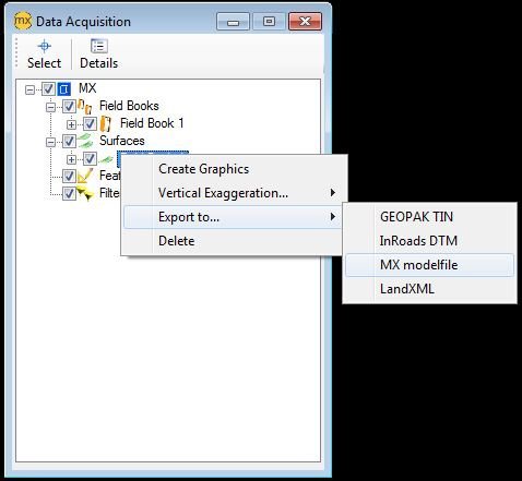

To transfer the survey to MX you need to select Export to MX in the right click menu as shown below. This function is available for Field Books and Surfaces.
When you click MX modelfile you will have to browse to the model.fil of the project and the model will be exported to a model with the same name. Field Book will export to a string model and Surfaces will export to a triangulation model.
