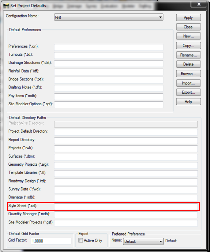

Where can I set the default location of style sheets (*.xsl).
Answer:
Users can set the default location of the style sheets in File > Project Defaults.
