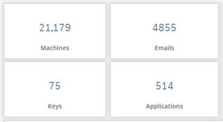

Layout - KPIs
The top left quadrant of the page has four key performance indicators.
Name
Description
Machines
Number of individual machines that have activated at least one Bentley product
Emails
Number of IMS Users that have activated at least one Bentley product
Keys
Number of Activation Keys that have been used to activate at least one Bentley product
Applications
Number of Bentley applications that have been activated at least once

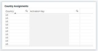

Layout - Country Assignments
Every Activation Key is associated with a specific country. This lists every Activation Key, that has been used at least once within the specified Date Range, and the country it is assigned to. This is equivalent to the Usage Country for non-SES usage.

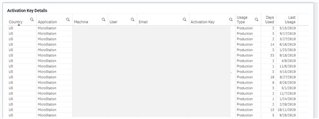

Layout - Activation Key Details
Details on the actual usage of the Activation Keys, including which product was activated and by who.
Name
Description
Country
Berechtigungsland
Application
Product and Feature String
Machine
Machine name
User
Windows NT User name
Email
IMS User's email address, if the user was logged in
Activation Key
Activation Key
Usage Type
Usage Type. Ex., Production, Trial
Days Used
Number of days this row applies to within the selected Date Range
Last Usage
The last time this activation key was used for this Application, Machine, User, and Email
