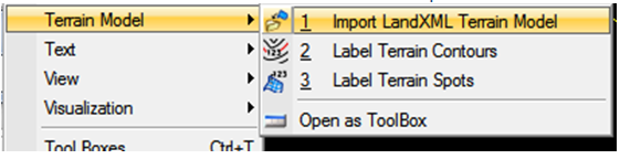

  1. Use the MicroStation Tools > Terrain Mode l> Import LandXML Terrain Model command to import the LandXML file as a MicroStation Terrain model.

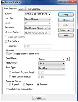

  3. Use the InRoads File > Import > Surface > From Graphics command to import the mesh as breakline features into a new InRoads DTM.
The result will be an InRoads DTM that triangulates exactly the same as the triangle faces contained in the LandXML file.

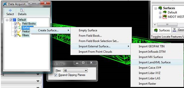

  1. Launch Data Acquisition (Tasks > Data Acquisition)
  2. In Data Acquisition, right click on Surfaces and select Create Surface > Import External Surface > Import LandXML Surface.

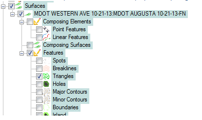

  3. After the surface is imported, turn OFF the display of everything except “Triangles”.

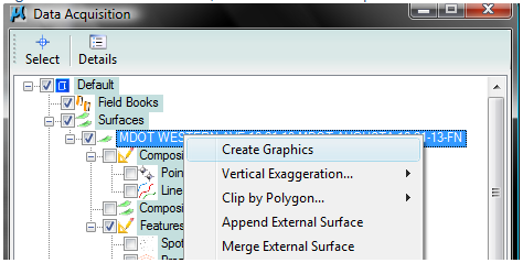

  4. Right click on the surface name, and select Create Graphics.  This will write the triangles to MicroStation graphics.

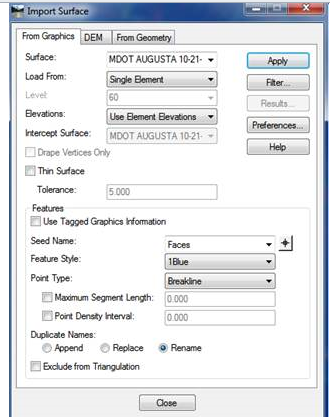

  5. Now you can use the InRoads File > Import > Surface > From Graphics command to import the graphics as breakline features in a new InRoads DTM.
