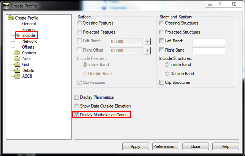

I have several manholes in my design that are cone types.  How can I display them as cones in my profile?
Answer:
To display manholes as cones in a profile, toggle on the option "Display Manholes as Cones" on the Include leaf of the Create Profile command.
