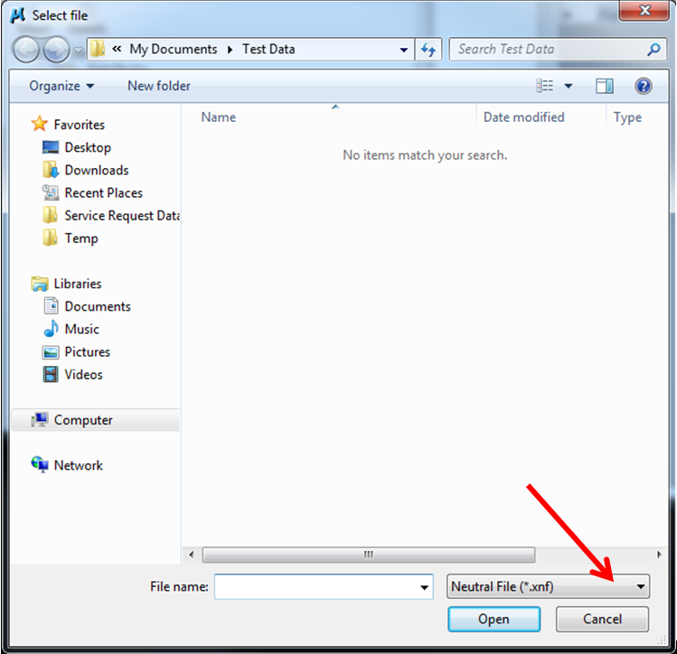

I would like to customize the Files of Type that are displayed when I attempt to load a file in Data Acquisition.

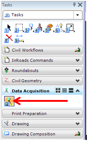

- Select the Data Acquisition icon in the MicroStation Tasks menu:

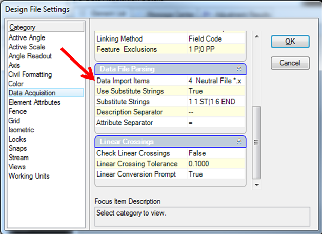

- In MicroStation, select Settings > Design File.
- In the left pane of the Design File Settings dialog, highlight "Data Acquisition". In the right pane, locate "Data Import Items" under the Data File Parsing heading:

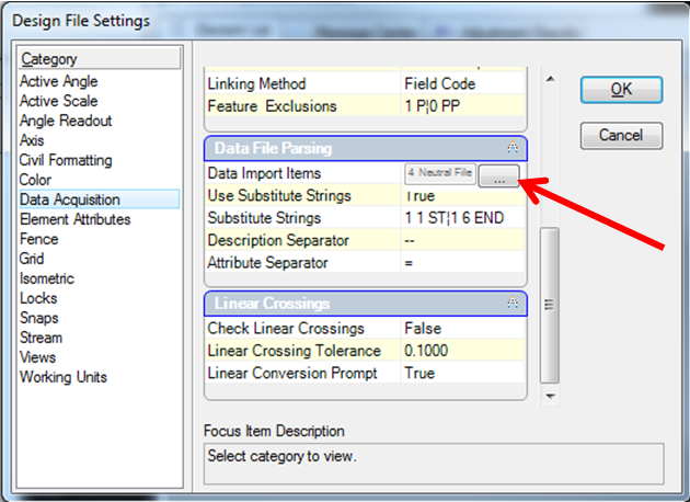

- Click on the file type that is listed and then select the browse button:

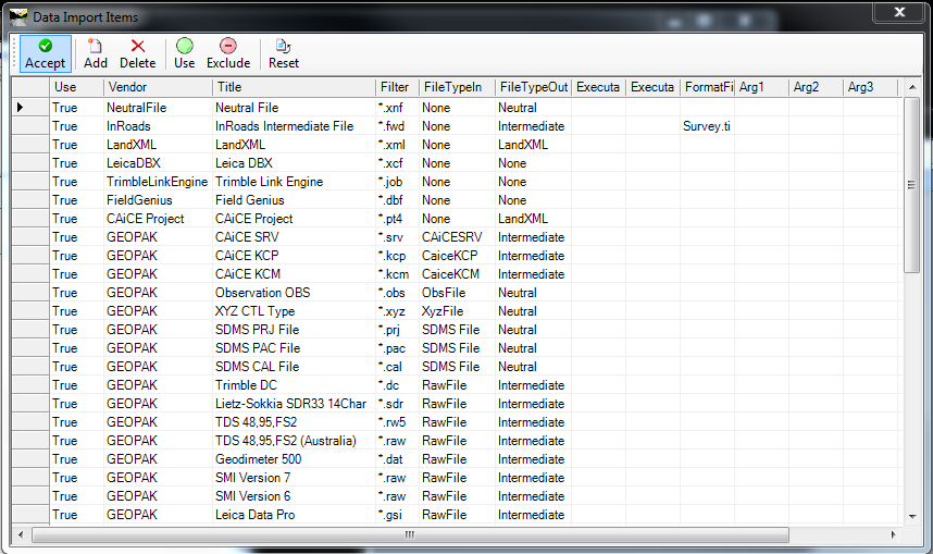

- In the Data Import Items dialog, you can choose to either Add, Delete, Use or Exclude various file types.
