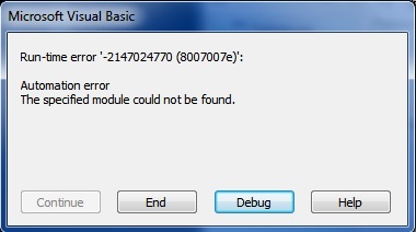

When running a VBA, such as the Cross Section Labeler, user gets the following error messages:
Run Time error
VBA
VBA programs that reference the Geopak 8.11 Object Library no longer work
or
Microsoft Visual Basic Run-time error
Automation Error
The specified module could not be found.
Explanation
This message is issued on a machine with both GEOPAK SS2 and GEOPAK SS3 installed.  When installing, the VBA files and DLLS are registered for the newer version.  Therefore, if the VBA files from the older version need to be run again, the "GEOPAKCOM.EXE"  for that specific version must be run to re-register the VBA and DLL files.

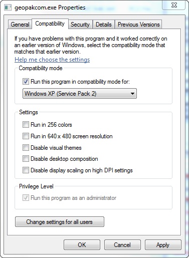

For SS2: go to "C:\Program Files (x86)\Bentley\GEOPAK\V8.11\bin" and execute the "geopakcom.exe" file.
For SS3: go to  "C:\Program Files (x86)\Bentley\GEOPAK\GEOPAK (SELECTseries 3)\bin" and execute the "geopakcom.exe" file.
Note: On some systems, it may be necessary to select the "Run As Administrator" option when executing the file.  For users who do not have sufficient rights to "Run as Administator", their administrator can set the compatibility for the geopakcom.exe file after installation as shown below...
