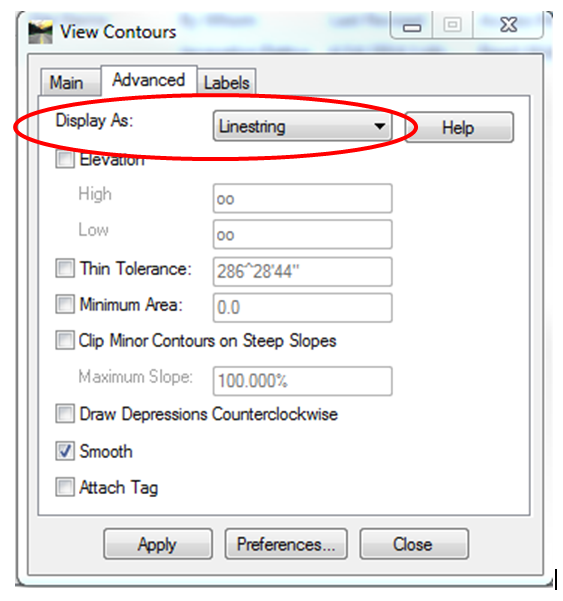

Contour Labels will not display.
Possible Solution:
On the Advanced tab of the View Contours dialog, Display As should be set to "Linestring" instead of "Lines" to enable the contour labels to display.
