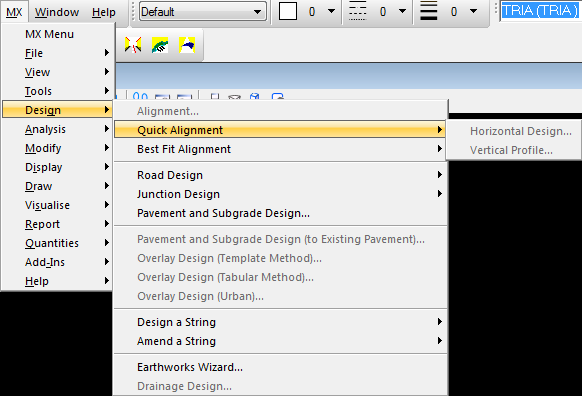

Problem Description
Some menu items are grayed out in MXRoad such as some of the Design menus as shown below.
Reason
The reason for this is due to MXRoad requiring a model to be drawn to the display in order to give access to the certain menus.
Steps to Resolve
Draw a model to the design such as a survey model and access will be give to the grayed out menus.
