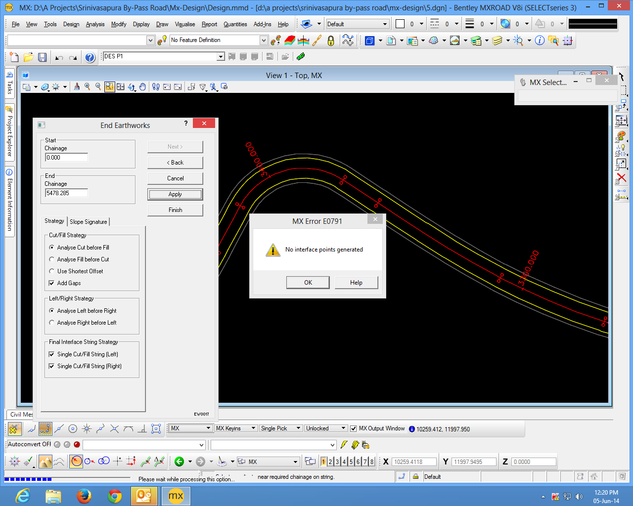

Earthwork Generation Error
Problem Description:
Generating Earthworks throws an error. Error as shown below.
Reason : Analysis with surface checker has not done correctly. Hence the run has been failed to find any Null points.
Steps to Resolve:
1. Analysis > Surface Checker > Check on Null points.
2. Delete the strings which are associated with the Null points then proceed Run surface checker.
3. Refer the help option for Errors and Warnings E0791.
