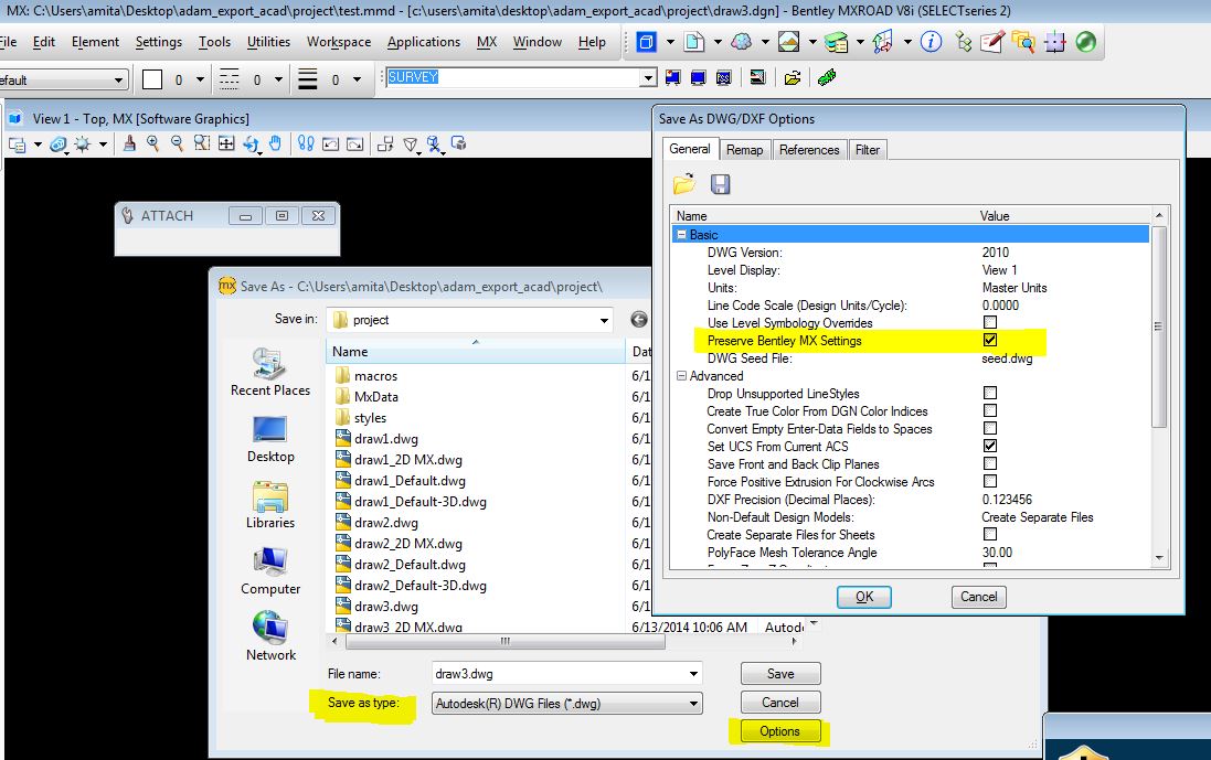

Export to dwg, linestyles does not appear as in MXRoad SS2
Following are the points to note while exporting to dwg:
1. Use "File > Save As" optionĀ from the CAD menu, instead of "File > Export > AutoCAD dwg". Save As option gives a good dwg output.
2. After the "Save as type" is changed to dwg, in the 'Save As' dialog box, hit the "Options" button to check following settings:
a. In the 'Basic' category, "Preserve Bentley MX Settings" is checked mark.
b. Expand the 'Fonts' category and check the 'SHX Output Directory'
Hope this helps.
