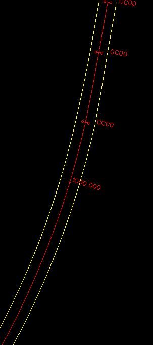

How do I get the road alignments to annotate automatically with ground levels, instead of Radius, chainage or RL values?

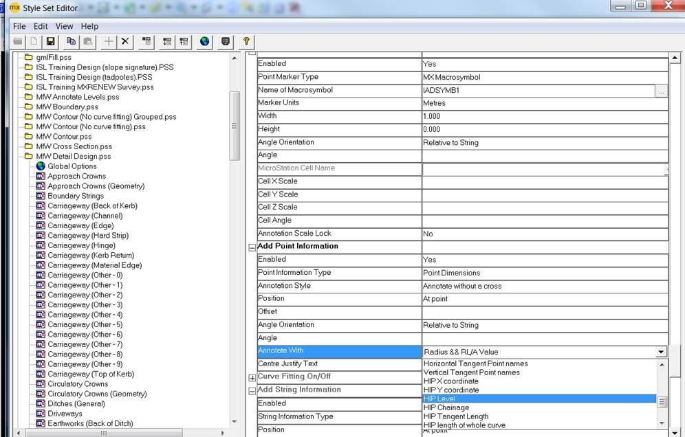

In order to get the alignment annotated as required with values like, Easting, Northing, level, HIP values etc, you will need to edit the style set. Following are the steps for same:
1. Go to "Tools > Style Set Editor" in MX menu, the "Style Set Editor" dialog box is displayed.
2. Double click on the style set that is been used say "MX Detail Design.pss" to expand it, double click on "Road Centerline Geometry".
3. In the right hand panel,  browse for "Add Point Information" and check for the option "Annotate With", change this to the value required for alignment annotation.
4. Save the style set. Change the style set for the design model with this new .pss file. Redisplay the model.
