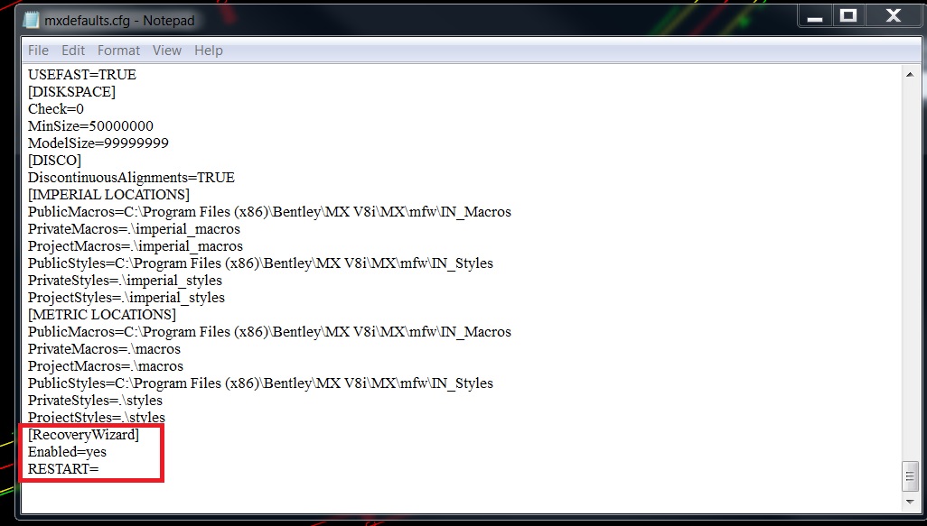

In order to start the MX Status Monitor, the MXDefaults.cfg file needs to be edited.
The MXDefaults.cfg is saved in the following folders::
Windows XP:
C:\Documents and Settings\All Users\Application Data\Bentley\MX\MXDefaults.cfg
Windows 7:
C:\ProgramData\Bentley\MX\MXDefaults.cfg
Add following lines to the file and save the file:
[RecoveryWizard]
Enabled=yes
The MX Status Monitor helps to close / restart MX when the application hangs, close MX options/dialog box that are running.
