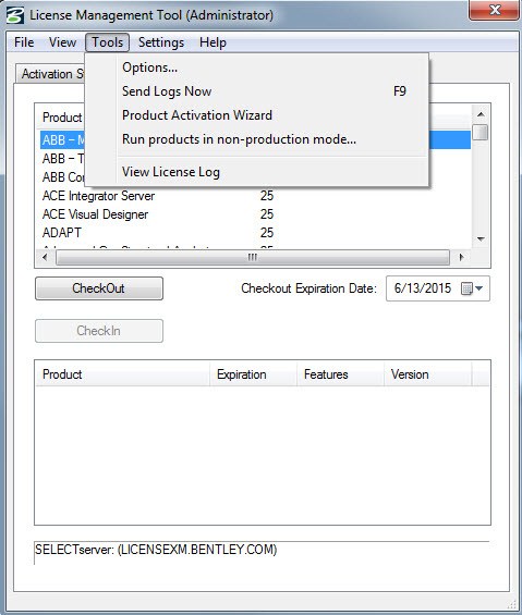

2. Select Utilities > License Management Tool.
 3. Select Tools > Product Activation Wizard.

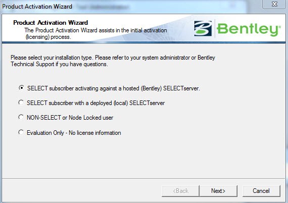

4. Choose the first option i.e. SELECT subscriber activating against a hosted (Bentley) SELECT Server and click Next button.

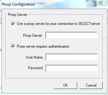

7.  If you are using a proxy server click on Proxy button and enter the Proxy Server and enter User Name and Password if there is one.

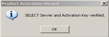

8. Click on Test Connection button and you should get the below message.
9. Click OK button, Click Next button

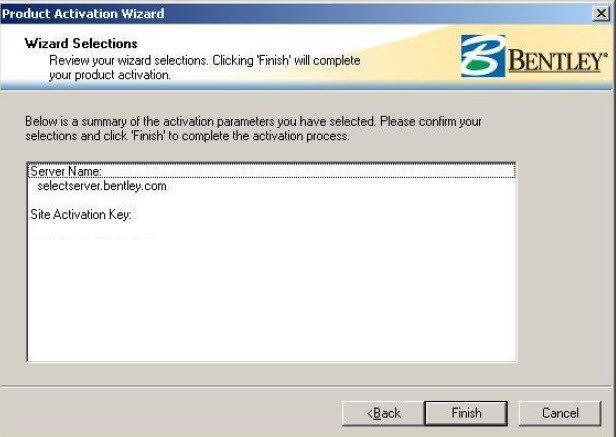

11. License activation details are displayed as shown below. Click Next button.
12. Click Finish button

14. Under the license tool go to View -> Refresh F5 and check if you can see the new license added.
