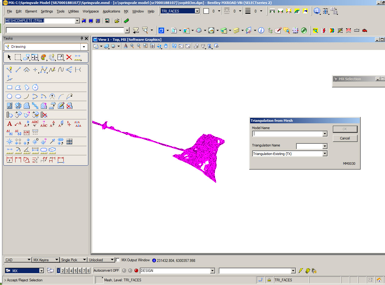

The mesh is from an AutoCAD .dwg file (a single polymesh for the whole terrain) referenced the same.dwg file into MX and then used "Merged into Master" to bring it into the MX model then after select mx export mesh 2tria, which fails silently in MX-Road.
Fail Result as shown below :
Workaround :

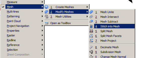

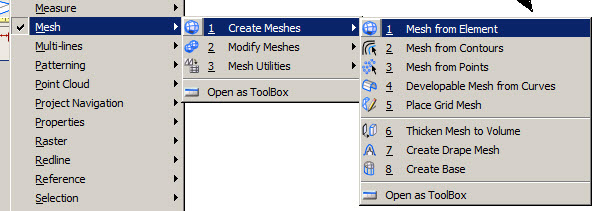

4. Go to CAD Menu > Tools > Select Mesh.
5. Mesh > Create Meshes > Mesh from Element > Select all data and accept the mesh.

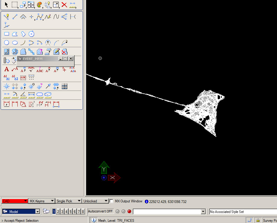

6. Again to Mesh > Modify Meshes > Stitch into Mesh > accept the data point.
7. Now use mx export mesh2tria key-in and result as shown below.
