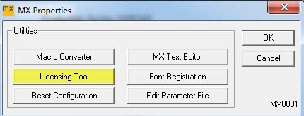

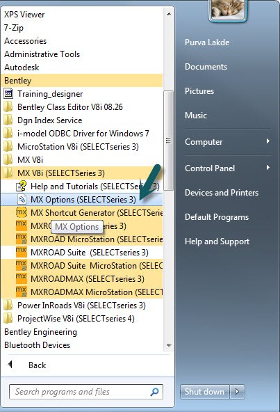

1. Open the License Tool. Go to Programs>Bentley>MX V8i>MX Options and select License Tool on the panel.
2. When the License tool open check that the license details are correct in Tools Options or enter the correct license info if required.

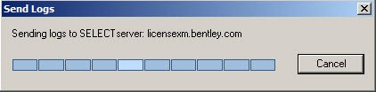

3. Select Tools>Send Logs Now
4. Select the product (MXRoad) and click Activate, do this even if the Status shows are activated.

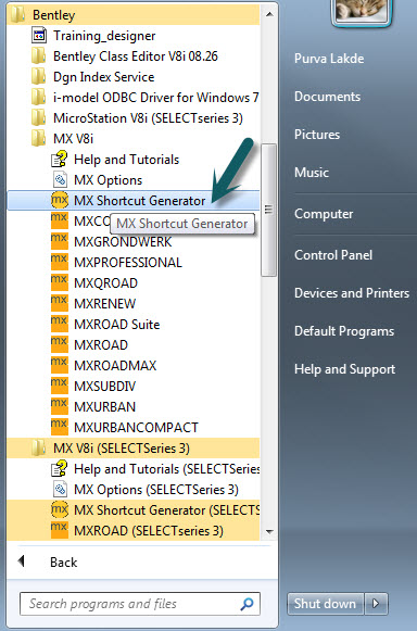

5. Delete the MXRoad shortcuts from the Desktop.
6. Go to Programs>Bentley>MX V8i>MX Shortcut Generator and recreate the Desktop Shortcuts for MXRoad.
7. This should get the software out of trail mode to licensed mode.
