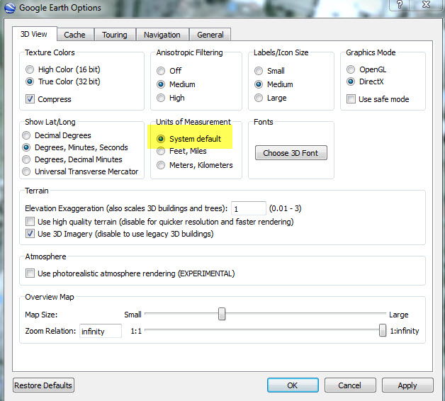

To get Exact Dimension in MXROAD :
1. Open Google Earth > Select Tools > Options > Select >System Default
2. You can change this units according to your drawing requirements.

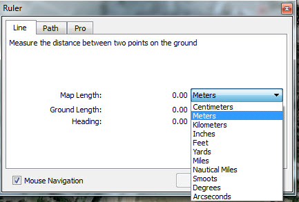

3. You can also change the units from Tools > Ruler in Google Earth.
Please let me know if you have any questions on the same.
