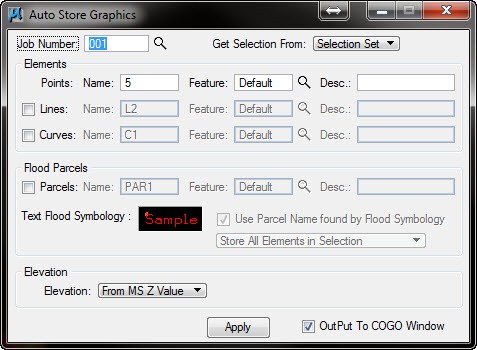

How to Store Graphical Points from Microstation in COGO with or without elevations.
Go to the Geopak > Geometry tools > Auto Store Graphics
You can select the points from a selection set and have Geopak read the MS Z value
