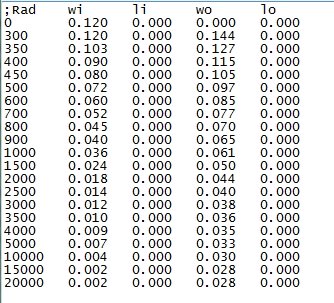

Where are the curve widening tables located?
Answer:
Curve Widening Tables are not delivered with InRoads.  You will need to create your own tables based on AASHTO guidelines and your design criteria.
The example below shows a widening table file:
Where:
Rad = Radius
Wid = Widening inside of curve
Li = Length of transition inside of curve
Wo = Widening outside of curve
Lo = Length of transition outside of curve
