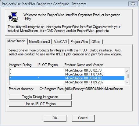

In the ProjectWise InterPlot Organizer Configure (Start\All Programs\Bentley\ProjectWise InterPlot Utilities\ProjectWise InterPlot Organizer\Integrate …) you can configure which MicroStation Version is acting as IPLOT Engine in ProjectWise InterPlot Organizer

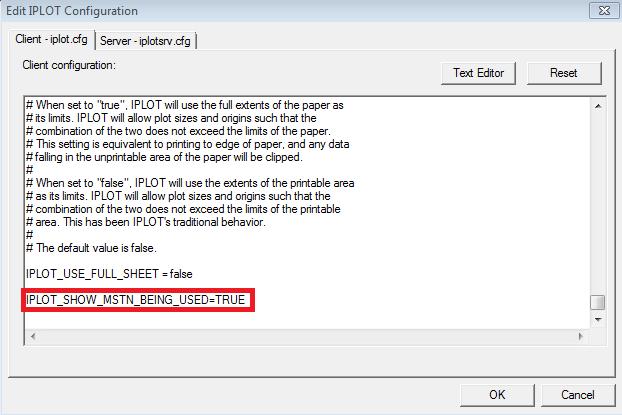

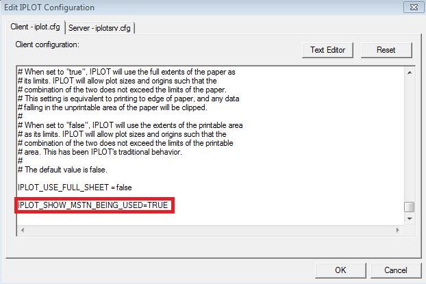

Which version for Microstation is acting as a  IPLOT Engine is then display in the status field of the ProjectWise InterPlot Organizer if you add the following variable in the  InterPlot configuration file iplot.cfg:
Start\All Programs\Bentley\ProjectWise InterPlot Utilities\ProjectWise InterPlot Organizer Configure \ Configure …-> MicroStation -> Edit… -> Client – iplot.cfg
IPLOT_SHOW_MSTN_BEING_USED=TRUE

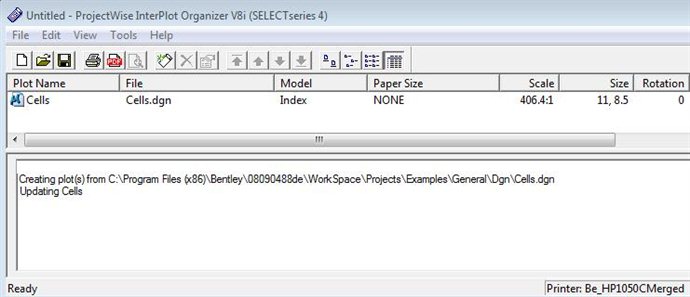

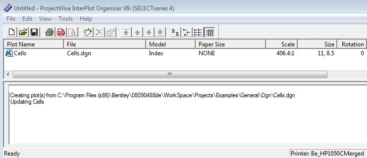

ProjectWise InterPlot Organizer without Variable. The ProjectWise InterPlot Organizer displayed ​​no specifications about the IPLOT Engine.

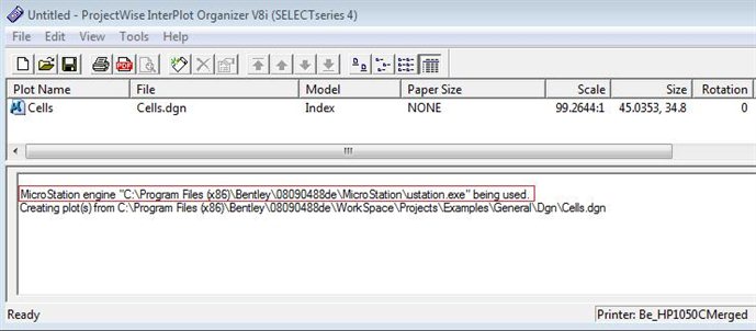

Example 1:

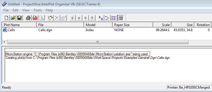

ProjectWise InterPlot Organizer with Variable. The ProjectWise InterPlot Organizer displayed that MicroStation XM 08.09.04.88 is acting as IPLOT Engine.

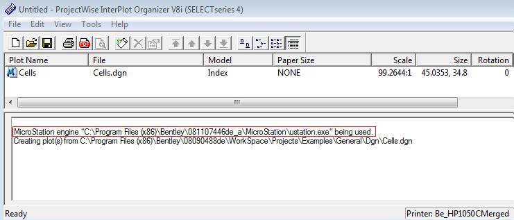

Example 2:
ProjectWise InterPlot Organizer with Varible. The ProjectWise InterPlot Organizer displayed that MicroStation V8i (SELECTserie 2) 08.11.07.446 is acting as IPLOT Engine.
