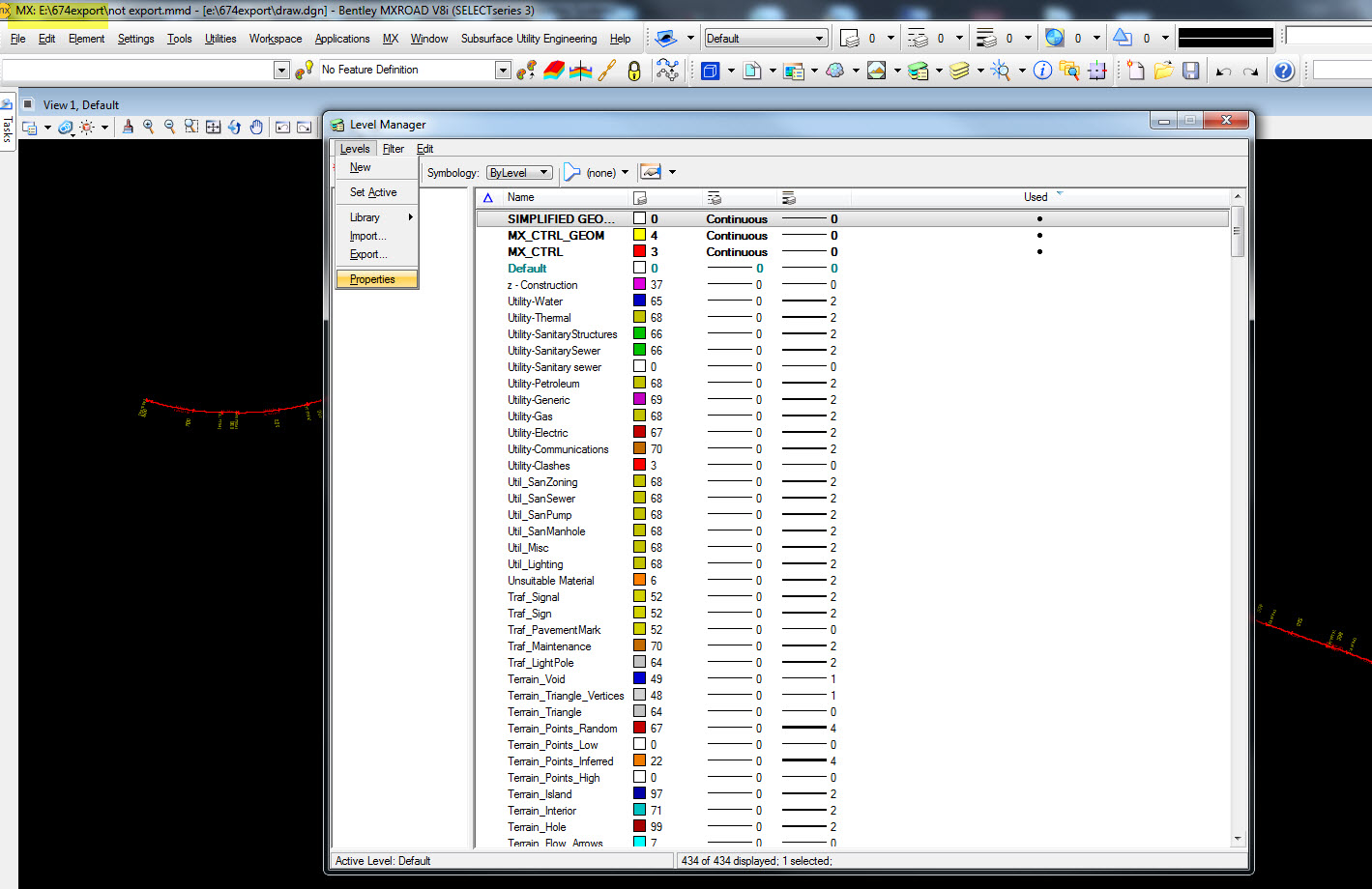

Use MX Menu: When export dgn to dwg through File > Export > dwg , it includes layer called "Simplified Geometry", this layer should manage to turn ON and OFF from being exported.
Workaround:
Turn off Layer Simplified geometry from being exported , please do the following.
1. Go to Level Manager > dialog box will open , Select Simplified geometry layer

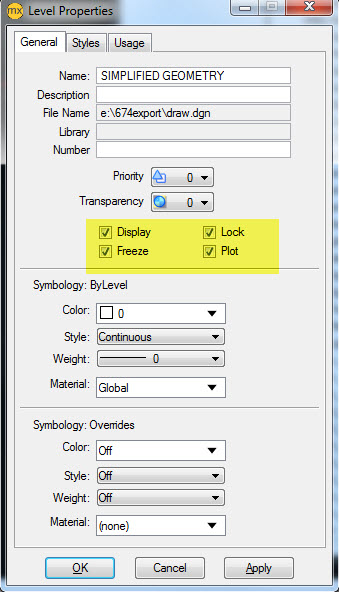

2. Then go to Levels > Properties check on option of Lock and freeze. This will off your selected layer from the display then export to AutoCAD and give new name to that file.
3. Create new plan display and attached dwg file as references and then merge it to current drawing.
4. You will see the selected layer off from the display.
