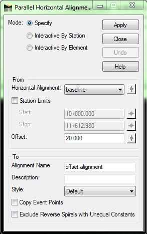

- Go to Geometry>Utilities>Parallel Horizontal Alignment.
- Create a new alignment that is offset from the baseline. In this example, I will offset the alignment by 20ft.

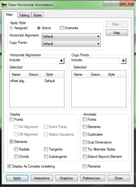

- Display the Horizontal Alignment as a complex linestring.

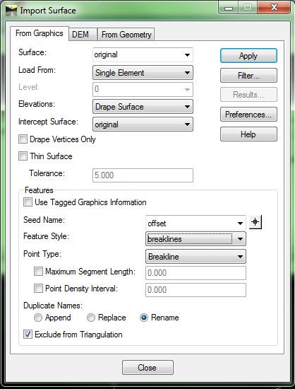

- Import the linestring as a surface feature, making sure to drape the elevations on the existing surface and set the feature to "Exclude from Triangulation".
![](967fc0be1bfd4e10dc6db99f034bcb00.iix)

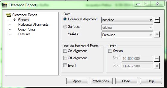

- Go to Tools>XML Reports>Clearance.
- On the General tab select the baseline alignment:
![](a67f04ba47f5ce1088c56642846d43ec.iix)

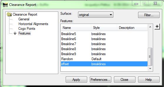

- Select the offset feature on the Features tab:
![](8f7f04be1bfd4e10dc6db99f034bcb45.iix)

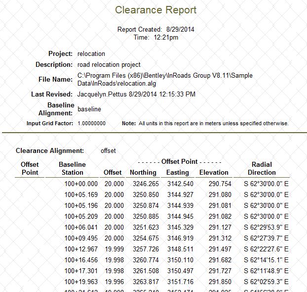

- Click Apply and the Bentley Civil Report Browser will display. The offset elevation will be reported in the Clearance.xsl report.
