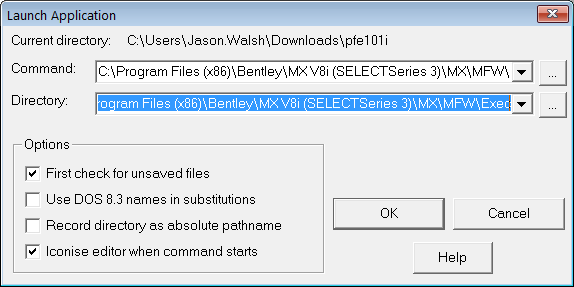

Go to Execute>Launch Application
Set up as below.
Command: C:\Program Files (x86)\Bentley\MX V8i (SELECTSeries3)\MX\MFW\Exec\bnlxInpRunOnce.exe %u\%d%s%f
Directory: C:\Program Files (x86)\Bentley\MX V8i (SELECTSeries3)\MX\MFW\Exec
The variable %u\%d%s%f will run the currently open file into the Input file runner.
Run by selecting the “Launch Application” icon or pressing Shift+F11.

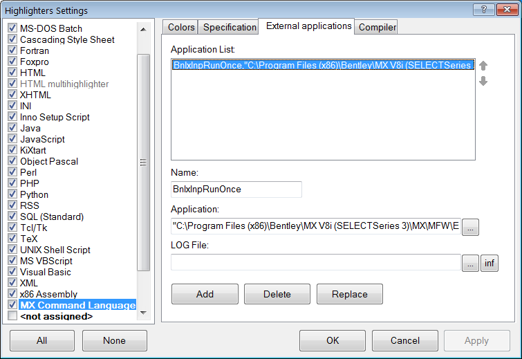

Go to Settings>Highlighter Settings and browse to the External Applications Tab
Set up as below.
Application: "C:\Program Files (x86)\Bentley\MX V8i (SELECTSeries 3)\MX\MFW\Exec\bnlxInpRunOnce.exe" "%File%"
The variable “%File%” will run the currently open file into the Input file runner. This is something which PSPad should add automatically when you browse to the application.
Run by selecting the “external applications” icon or pressing F9.

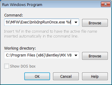

Go to Advanced>Run Windows Program.
Set up as below.
Command: C:\Program Files (x86)\Bentley\MX V8i (SELECTSeries 3)\MX\MFW\Exec\bnlxInpRunOnce.exe %f
Working Directory: C:\Program Files (x86)\Bentley\MX V8i (SELECTSeries 3)\MX\MFW\Exec
The variable %f will run the currently open file into the Input file runner.
Run by pressing F10.

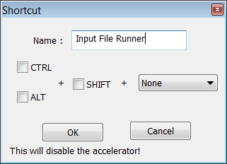

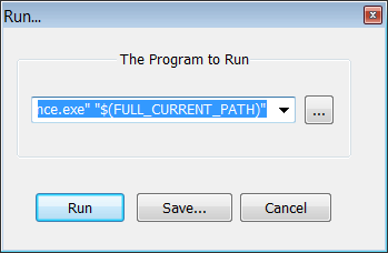

Go to Run>Run.
Set up the path as below.
"C:\Program Files (x86)\Bentley\MX V8i (SELECTSeries 3)\MX\MFW\Exec\bnlxInpRunOnce.exe" "$(FULL_CURRENT_PATH)"
The variable "$(FULL_CURRENT_PATH)" will run the currently open file into the Input file runner.

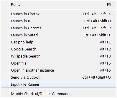

Select Save to set up a shortcut to run the input file runner.
Run by selecting Input file Runner from the Run Menu.
