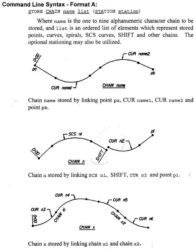

How do you Store a chain with a shift in Geopak Cogo
Steps to Resolve
  1. open microstation
  2. go to Cogo
  3. in the cogo key in use the commands shown below
