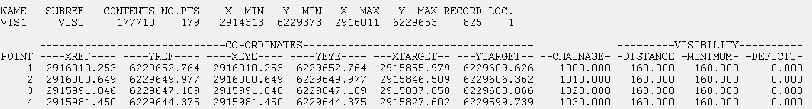

The string where the visibility details are stored can be report and will give the details below.
