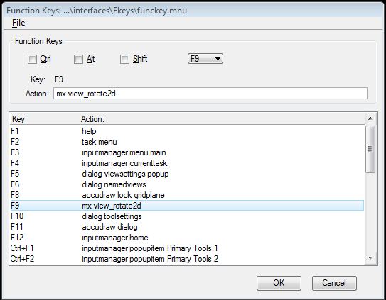

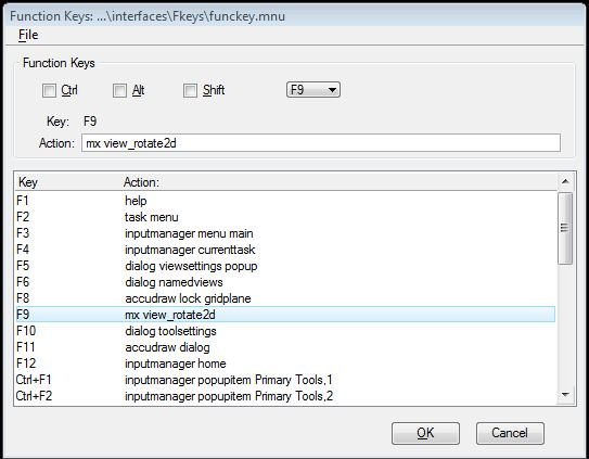

Some users prefer to have 2D rotate function to interrogate design models in MX. This can be set up as a Function key as below.
Go to Workspace>Function Keys. Select a suitable Function key and assign the key in mx view_rotate2d. The screen shot below shows function key F9 set with the rotate 2D key in.
