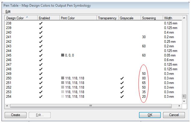

MicroStation Pen Table (or Autocad CTB) can have Screening factors.
Is there an InterPlot Design Script Assignment Keyword that corresponds the MicroStation Pen Table (or Autocad CTB)  “Screening” setting?
We do not have an exactly the same InterPlot Design Script Assignment Keyword.
The InterPlot Assignment Keyword Transparency is equivalent to the Screening keyword in MicroStation Pen Table (or Autocad CTB), but the values are reversed, so Screening = 20 in the MicroStation Pen Table would be Transparency=80 in the design script.
