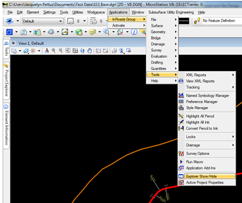

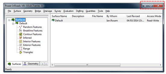

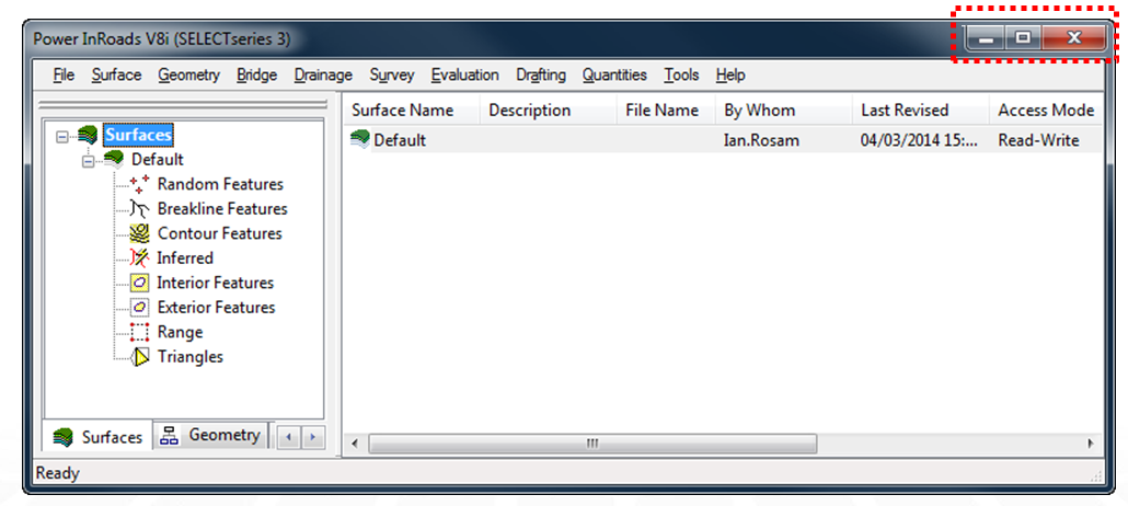

How do I close or minimize the InRoads Explorer in SS3?  The "X" to close it and the "-" to minimize it are missing.
Due to the increasing integration of the civil commands with MicroStation, there are a number of files that must be loaded at the time MicroStation is launched in order for the products to load properly.  For this reason, it is no longer possible to launch MicroStation alone and then launch InRoads.  In addition, users will benefit from a simplification of the license usage that is reported to Bentley.
To hide the InRoads Explorer window, users should select (in the MicroStation menu) Applications > InRoads Group > Tools > Explorer Show/Hide.
