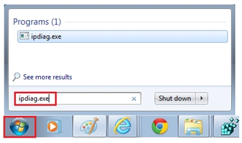

Select the Windows Start Button and type in ipdiag.exe <Return>
The ProjectWise InterPlot Diagnostic command line interface opens.
You can choose between different options. The option <f> created a diagnostic report including all categories.
Chose option <f> <Return>
Enter the output directory and the file name.
Example: c:\tmp\Client_diagnostic.txt

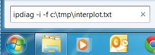

Sometimes it is necessary to create only a portion of the report. For example to get only the ProjectWise InterPlot Report ...
Ipdiag –i –f c:\tmp\interplot.txt
