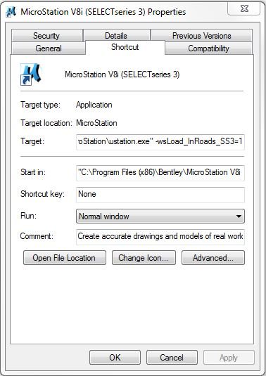

No Civil Tools under the Task menu when launching InRoads
Version(s):08.11.09+
Area: Basic Settings
Original Author:Andrea Garecht, Bentley Technical Support Group
Why are the Civil Tools Task menu options missing when I launch InRoads from within MicroStation in SELECTseries 3 (SS3)?

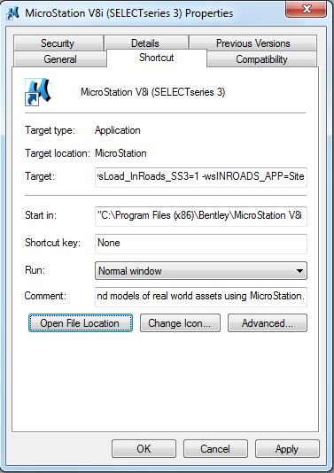

Beginning in SELECTseries 3, InRoads products are merged into the MicroStation Task menu options and each product offers different commands.  When launching the product(s), they require an additional switch on the target of MicroStation so that the correct commands load with MicroStation.  Please see the following list for the switches that should be added after the command line switch (-wsLoad_InRoads_SS3=1).
 See the following example for the Bentley InRoads Site product.  Go to your shortcut for MicroStation > right click > Properties > Shortcut > Target:
