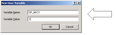

Create a new system variable name DP_ARCV and give the variable some value (such as 1)

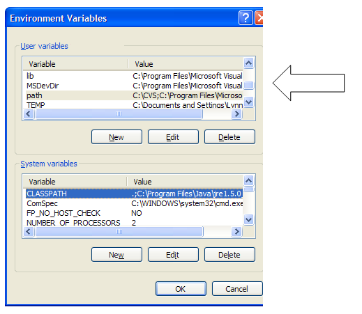

 From START>Settings>Control Panel>System, click on the Advanced Tab. Navigate the mouse to the “Environment Variables” button. The following dialog should appear.

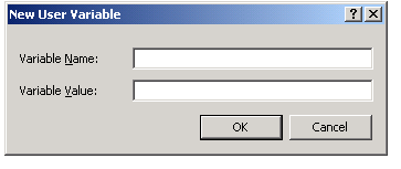

In the User variables section, select “New”
In the case of the ProjectWise Plotting Driver Pack, you must use the variable name DP_ARCV and give the variable some value (such as 1)

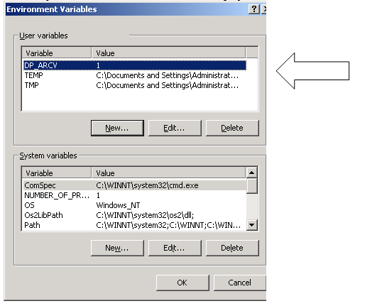

The newly created environment variable will display.
Once this user environment variable is set, the customer should reinstall the ProjectWise Plotting Driver Pack.
This will copy and install all of the drivers.
