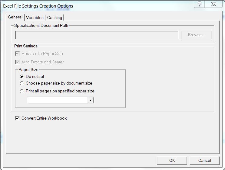

1 - Create a settings file converts the entire workbook.
In InterPlot Organizer, create a binary settings file. In the Excel section, enable "Convert Entire Workbook".
2 - Configure the rendition presentation component to use this settings file.
3 - Configure the rendition profile to use the rendition presentation component created above.
