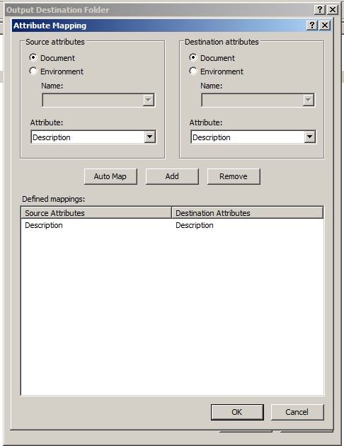

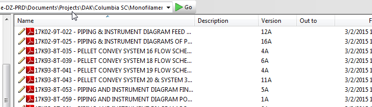

I would like to take the description current assigned to the design file be applied to the description field in the rendition folders.  I currently have the file name pattern set in the rendition output file naming convention to append the document.description to the document.basename.
The screen shot below is from the renditions folder where the renditions are created per the rendition profile.  The name is a result of appending the description to the name.  I’d like the description to be its own entity.
Steps to Resolve
You can accomplish this by setting Attribute Mapping on output Destination Folder rendition component.  Like this:
