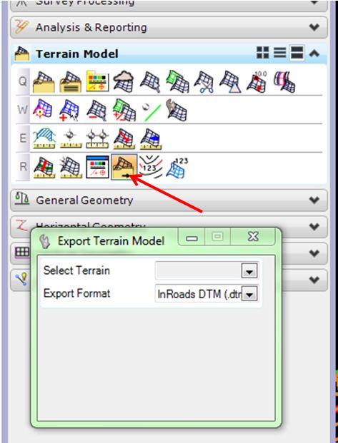

How do I export an OpenRoads terrain model to native format?
Answer:
Use the command Export Terrain Model located in the Terrain Model task menu.
The Terrain Model can be exported to :
GEOPAK (TIN)
InRoads (DTM)
MX (FIL)
LandXML version 1.2
Note: Additional prompts are required when exporting to MX or LandXML formats.
