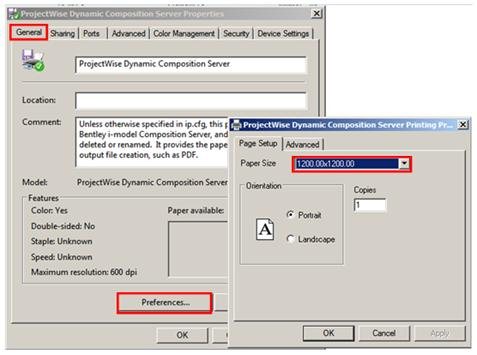

What are the recommended settings for the ProjectWise Dynamic Composition Server printer driver?
 Product(s):Bentley i-model Composition Server
 Version(s):N\A
 Environment:N\A
 Area:PDF
 Subarea:N\A
These are the recommended settings for the ProjectWise Dynamic Composition Server printer driver?
Open the printer properties of the ProjectWise Dynamic Composition Server -> General -> Preferences … and set the largest Paper size 1200 x 1200 -> OK -> OK

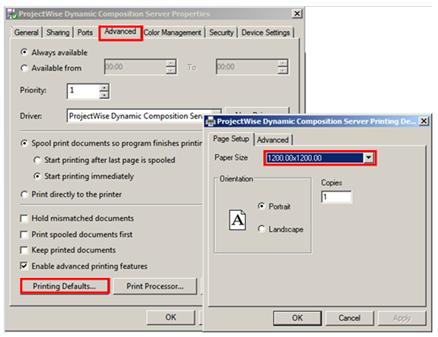

Do the same for the Printing defaults …. Advanced -> Printing Defaults … -> and set the largest Paper size 1200 x 1200 -> OK -> OK

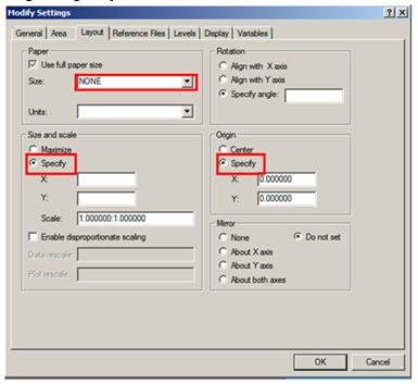

In the IPLOT Settings file set:
Paper size = NONE
Size and Scale = Specify
Origin = Specify
