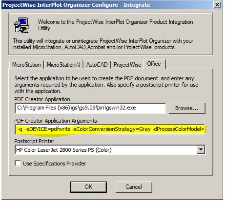

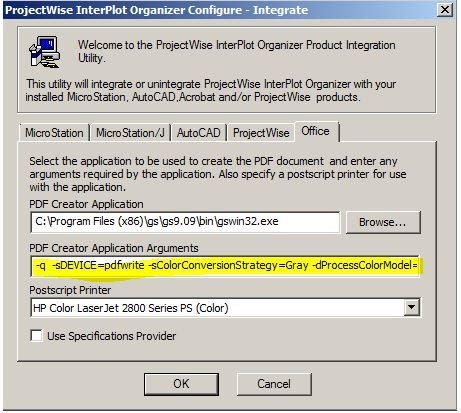

-On the iCS for PDF server, open ProjectWise InterPlot Organizer Configure as Administrator and select Integrate.
-Select the Office tab
-Define Ghostscript as the PDF Creator Application. The latest release of Ghostscript can be downloaded from SOURCEFORGE.NET.
-Use the following PDF Creator Arguments:
-q  -sDEVICE=pdfwrite -sColorConversionStrategy=Gray -dProcessColorModel=/DeviceGray -dCompatibilityLevel=1.4 -dNOPAUSE -dBATCH -sOutputFile=
-Define a Postscript printer. If you do not see a Postscript printer in the list box, exit the configure dialog and create one.
