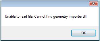

Unable to read file, Cannot find geometry importer dll
Product(s):GEOPAK
Version(s):08.11.09+
Area: General Geometry
Original Author:Kevin McDonald, Bentley Technical Support Group
Choosing the General Geometry>Import Geometry to import an ALG file gives the error message "Unable to read file, Cannot find geometry importer dll."
Download and save the file "Bentley.Civil.Geometry.Services.InRoads.3.0.dll" into the folder “C:\Program Files (x86)\Common Files\Bentley Shared\Civil Platform\08.11.09”.  Restart MicroStation/GEOPAK.
