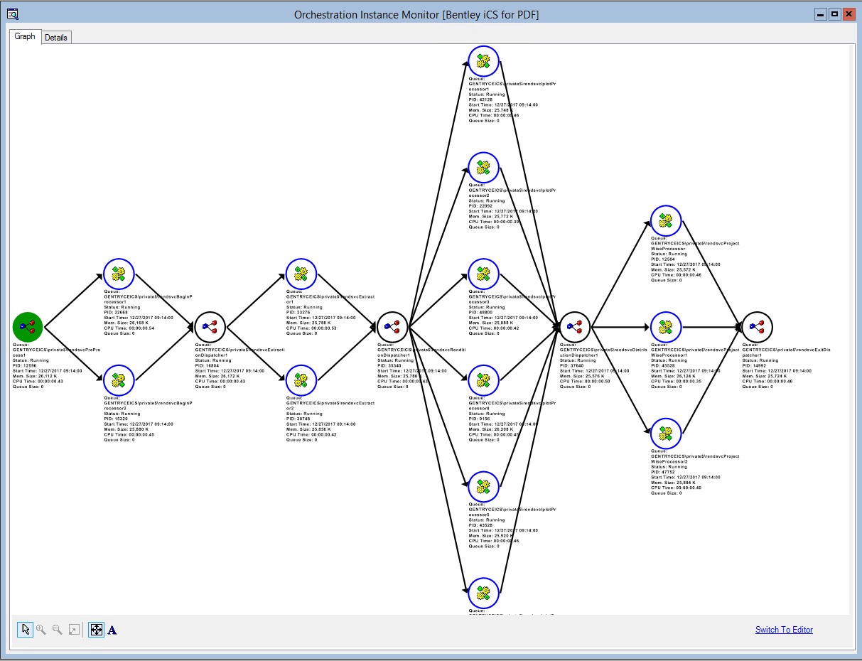

There are four processors that can be adjusted for performance
The Begin Processor, new in iCS for PDF CONNECT Edition, is responsible for performing job initialization tasks.  For large incremental jobs, these tasks may take a significant amount of time and block other jobs from starting.  If your workflow involves large incremental jobs, or multiple jobs starting simultaneously, configuring two or more Begin Processors can improve performance.
The extraction processor copies down the files to the iCS for PDF server.
The InterPlot Processors creates the output files (i.e. PDF).  It is a combination of InterPlot Organizer and a publishing engine. Each InterPlot processor starts its own iplotorg.exe which in turn starts the publishing engine (i.e. mstation.exe) to process the input data.  After 50 jobs, the iplotorg.exe will restart.
The ProjectWise Connector moves the output files to the destination (back into PW).

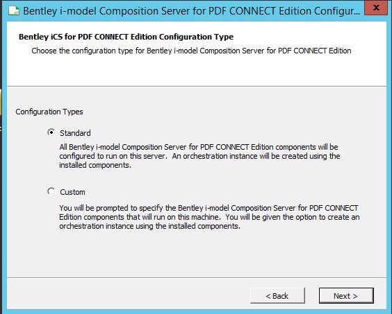

To configure the processors, run the Bentley i-model Composition Server Configuration in “Run as Administrator” mode. This configuration will read the initial setup from the Orchestration Framework database.   Accept the defaults until you get to the following dialog:

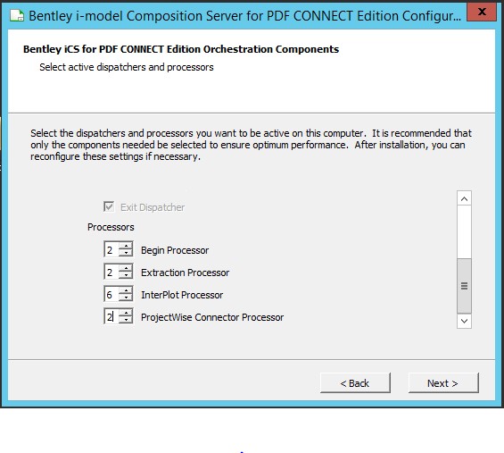

Choose "Custom" to specify the number of processors – be sure to scroll down:
The key to optimizing iCS for PDF is to set a base number and watch the CPU and RAM as you process a large job and make sure that the CPU and RAM do not spike. Many variables can alter this ratio:
A good starting point is 2 Begin Processors, 2 Extraction Processors, 6 InterPlot Processors and 2 ProjectWise Connectors. After you have set the processors, run a large job, say over 100 files and watch the CPU and RAM.  The CPU will spike at the beginning as the Begin/Extraction processors start to download/process the files and with MicroStation starting up and then level off.   If the CPU stays low then you will want to increase InterPlot Processors. If the CPU stays high then you will want to lower the InterPlot Processors. The Begin/Extraction processors and Connectors can stay at 1 or 2 for each because these processors copy down the files faster than the InterPlot Processors can process the files and the Connector can upload them faster than the InterPlot Processors can finish processing.

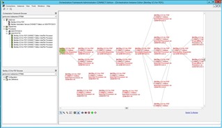

In Bentley i-model Composition Server Administrator, right click on the “Bentley iCS for PDF” instance and select Monitor. In the lower right corner, select "Switch To Editor”.
When in Editor mode, the icons are as follows, left to right:
Drag the IPLOT processors over from the Processors list on the left into the graph area. In the diagram below, the "Display Text" icon was selected to show the queue names.
  1. Using the "Create link" icon, link to the appropriate component.
  2. To create the first link, select the Rendition Dispatcher node first, select "Create link", select the new InterPlot Processor node.
  3. To create the second link, select the new InterPlot Processor node, select "Create link", select the Distribution Dispatcher node.
  4. Repeat these steps for each new InterPlot Processor node.

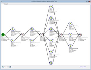

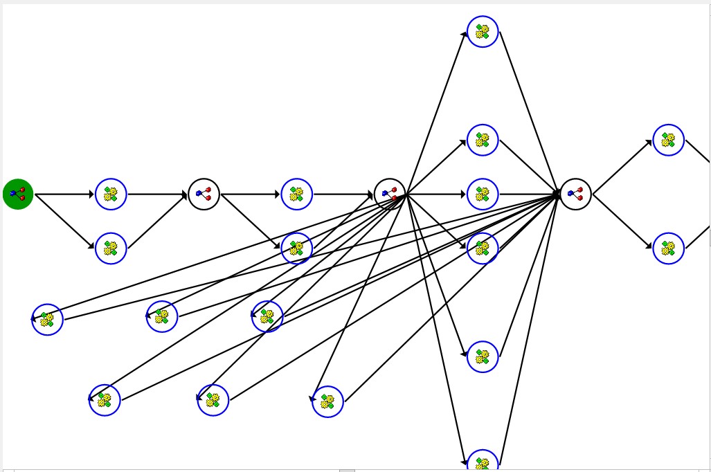

Once completed, the graph will look like the following:
Choose the "Auto Arrange" icon and then "Switch To Monitor":

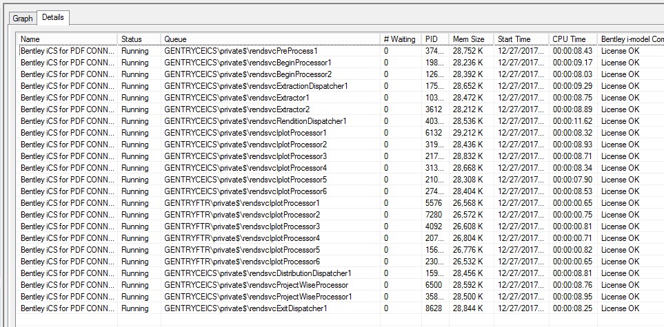

The picture below shows the details on the graph. You can see InterPlot Processors for the primary iCS server – GENTRYCEICS and the new InterPlot Processors for the secondary iCS server – GENTRYFTR.
The additional server will be used to process the PDF files in InterPlot Organizer – this is where the heavy workload takes place on an iCS for PDF server.
