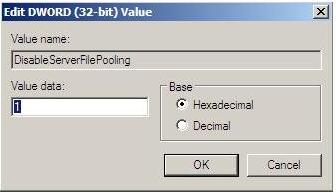

1. The "File Pooling" feature must be turned off on the ProjectWise InterPlot Server before you can print from the plotting interfaces.
To turn off "File Pooling “on Windows Server 2012:
From a command prompt, type: regedit.
Locate the registry key "HKEY_LOCAL_MACHINE\System\CurrentControlSet\Control\Print."
Select Edit -> New -> DWORD (32-bit) Value.
Set Value Name to "DisableServerFilePooling".
Set Data to "1".
Exit the registry and reboot the machine.

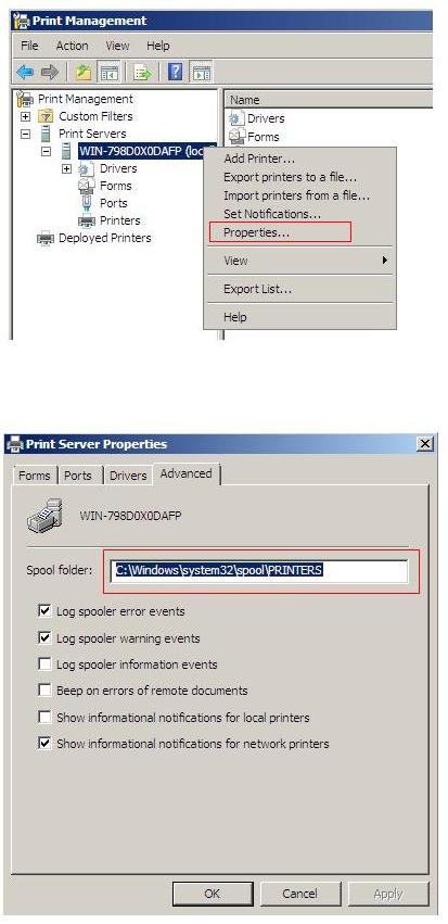

8. On the ProjectWise InterPlot Server set permissions for "Everyone" to "Full Control" on the spool directory if global access to the printer is the norm. Access to the spool directory can also be enabled on a user by user basis.
Please note that the spool directory may be located in a different directory. You can configure the location of the spool directory as followed:

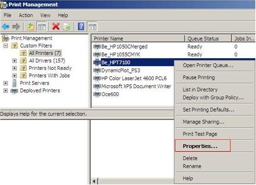

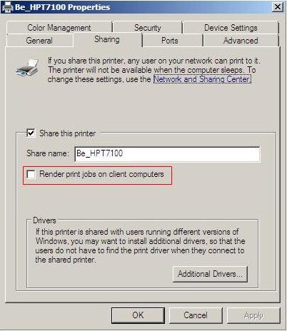

9. It may be necessary to unset the "Render print jobs on client computers" check box on a Windows Server 2008 and Windows Server 2012
To disable "Render print jobs on client computers"
Select Start > Devices and Printers.
Double-click the printer and select Printer > Properties.
Click the Sharing tab.
Unset Render print jobs on client computers.
Click OK.
