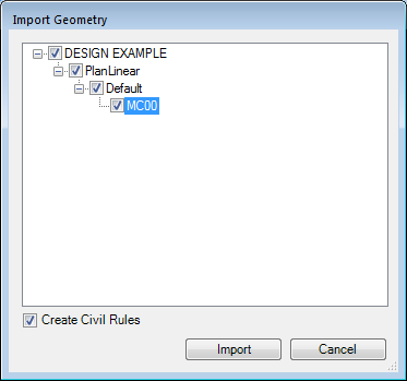

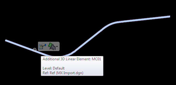

The example below shows how to use the Plan By 3D Element Tool on an imported MX 3D non alignment element.
- Use Import Geometry to import the MX 3D non alignment element.
![](2d1c00f61b7d4e10dc6db99f034bcb77.iix)

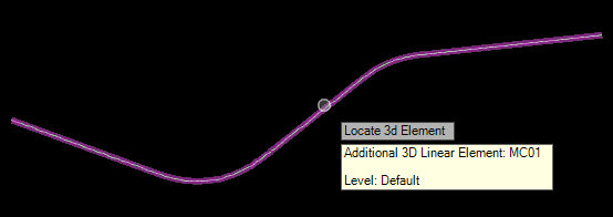

- The element will show as an Additional 3D Linear Element and have a limited popup menu.
![](d21c40f61b7d4e10dc6db99f034bcb50.iix)

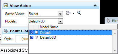

- Switch to the Default-3D Cad Model
![](be1c44369735ce10afb952800153afc9.iix)

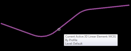

- When you hover over the element it now should show as Current active 3D linear element.
![](782c003647798e10e3378d53636d434c.iix)

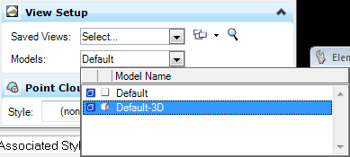

- Switch back to Default Cad model.
![](cd2c88369735ce10afb952800153af9d.iix)

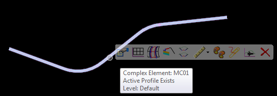

- When you hover over the element it shows as a Complex element which has an active profile. The full pop up menu will show now for the element.
![](552c003647798e10e3378d53636d4356.iix)
