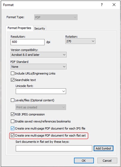

A new checkbox in the rendition profile PDF format dialog controls whether to create a multi-page PDF when the input set consists of a single flat set.  If this box is checked, a second "sort order" field is enabled allowing a list of symbols to be specified that control the order of renditions in the multi-page PDF.
By default, the sort order field is blank.  In this case, renditions in the multi-page PDF are sorted by their individual PDF file names -- which are the result of the "rendition base file name" pattern specified in the rendition profile file naming convention.

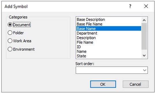

The "Add Symbol" helper dialog is like the ones used elsewhere in ProjectWise Administrator, but displays a reduced set of symbols useful for sorting.
Like the "Create one multi-page PDF document for each IPS file" checkbox, the "Create one multi-page PDF document for each flat set" checkbox is only honored if the job's input set consists of a single flat set.  If the input set contains multiple flat sets, or a combination of a flat set and one or more individual documents, the checkbox is ignored, and multiple renditions are created and distributed.  This allows the same rendition format option to be used with different jobs.

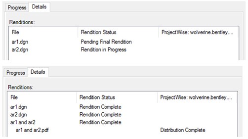

Similar to processing of an IPS file, when creating a multi-page PDF from a flat set, the iCS for PDF Administrator job monitor displays the status of each input master document individually.  After each rendition is created, the status of the master document changes to "Pending Final Rendition".  When all renditions have been created, the multi-page PDF is assembled and distributed.
Unlike IPS processing, if an error occurs when creating an individual rendition, the entire job fails, and no multi-page PDF is distributed.  Whereas for an IPS input, a multi-page PDF would be distributed with one or more "Error" pages inserted in place of the missing rendition.
